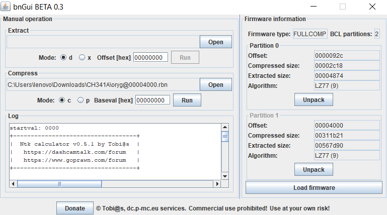

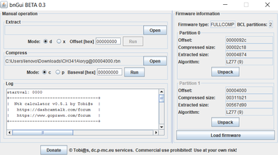

  2. Ok, but I have 2 BCL partitions in my firmware not 1...flashing your firmware with 36bitrate will kill it ?
  3. There's one section, it will not kill.
    And if he kills, there's a full firmware.
    At me does not kill !! :)
  4. [QUOTE = "valeri07, post: 136538, członek: 11881"] Jest jedna sekcja, nie zabije.
    A jeśli zabije, jest pełne oprogramowanie układowe.
    U mnie nie zabija !! :)[/ QUOTE]

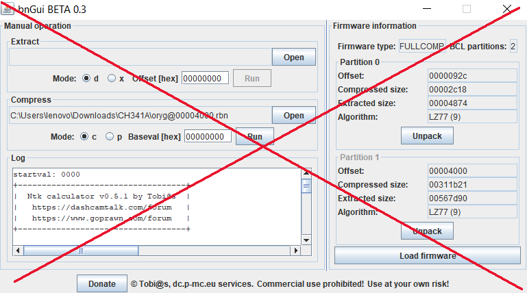

    S I must flash with SD Card- I can't with a programmer ? I made a firmware from my original with 11600bitrate (x2) and BnGUI made firmware with 1 BCL ...it's strange that it can't made full compressed firmware from 2 partitions.
      28,6 КБ
      799
  5. This is not the tool
    And you do not need it.
    From the full firmware, do the firmware is wrong.
    And why do you need it, my much better!
    #2264 valeri07, 17 апр 2018

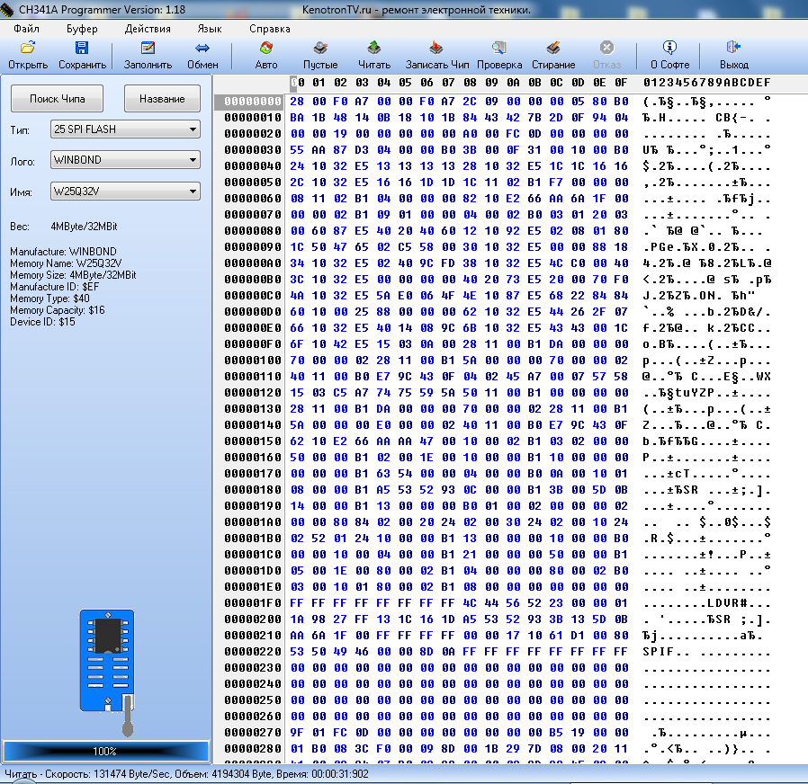

  6. Now I see that programmer detect chip3205D but on chip is 3206E....strange
    #2266 valeri07, 17 апр 2018

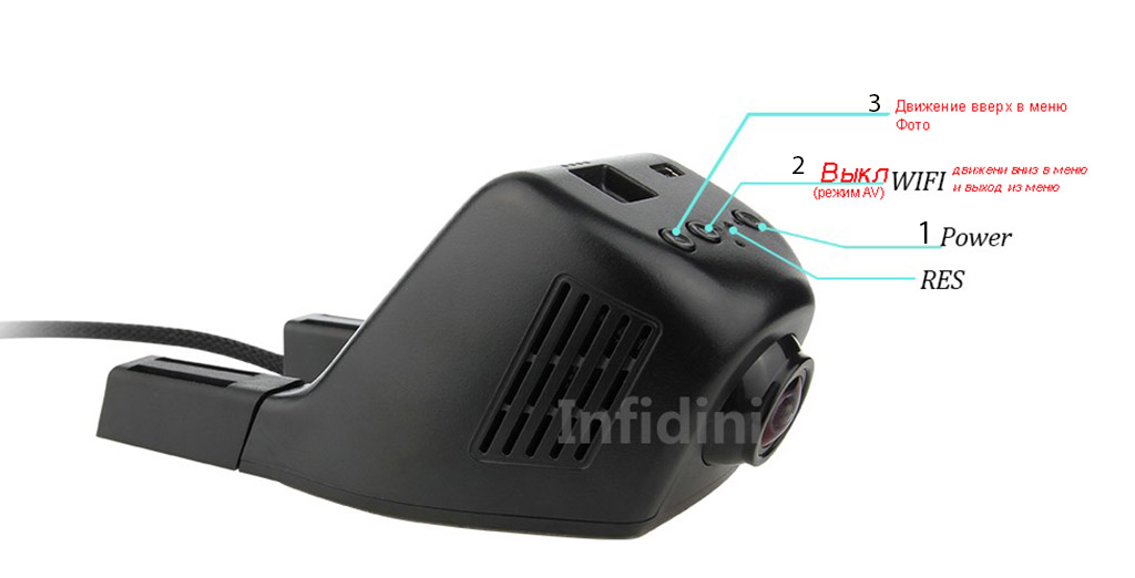

  7. OK,Your firmware is working but...I have only power ON/OFF button and Wifi and 3 is not active and on Car screen I can't change any options....and night mode are very darkwith more "orange skin" then in my.....quality is awsome :) Now I am able to see car plates on my firmware and my xenon light I saw only plates full of white color :) Could You please tell that in Your firmware there is option to change saturation ? on my firmware was....maybe You want to cook my firmware with 36mb bitrate and whole buttons will be active :)?
  8. Yes, it's weird ....
    Buttons should work.
    I'll check the firmware for errors tomorrow !!
    Which one did you put 1 or 2?
    You can always go back, I'll then look at your firmware, what's wrong there !!
    But what about the buttons?
    Button functions!
    #2268 valeri07, 17 апр 2018
  9. I flashed 1 with 36MB bitrate...I have power on left, now Wifi turn ON/Off on center, next the third is not working and 4 RESET have not checked yet...now I cant turn OFF sound and change any options.
    Oh and LEDs dont work at all
    #2269 anikocio, 18 апр 2018

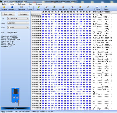

  10. You need to flash CH341A - my full firmware(12345.BIN).
    I'll take a look at yours, my own, but it's bad.
    Show the video.
    Your firmware with bitrate 20, only WIFI!
    On the smartphone, what program do you use - FN Sam?
    https://drive.google.com/open?id=1a04IbjEYfFMuCIu_mCJhjeT7R3223UZi
    #2270 valeri07, 18 апр 2018
  11. I used TimaCam. Why my firmware is bad ? To edit with 36mb bitrate ?
  12. Bitrate here is not.
    The interface is bad.
    Here is my!
    #2272 valeri07, 18 апр 2018
  13. I hade similar interface when I was press buttons and power but with some chinese on down side. I want to have 36mb bitrate on my firmware...leds are ok and icons on interface that i can operate without problems or tweak yours.....for now I'm missing leds ....i dont know that dvr is working or not
  14. Until my full_firmware(12345.BIN) is stitched it's hard to say why !!
  15. Is it possible to flash fullfirmware with sd card ? I dont wont to desolder chip again because I dont have much time this week.
  16. no, only through CH341A
    try it while yours, I did to you with a bitrate of 20 under the TimaCam

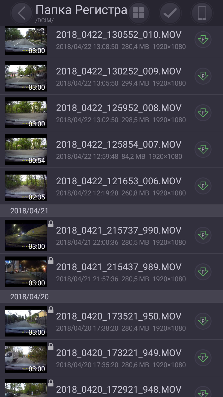

  18. Подскажите, почему на некоторых файлах висит замочек и не могу удалить их через телефон, приходится переодически форматировать карту памяти.
